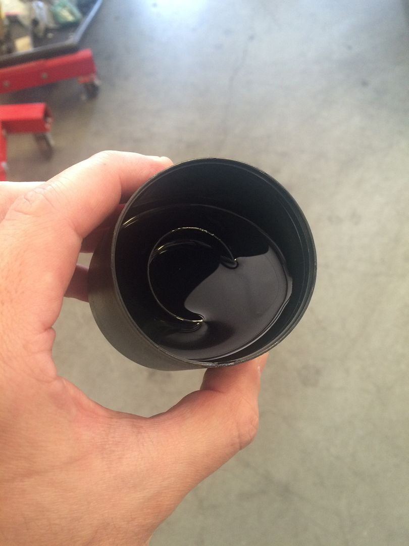

Just had Evan do complete fluids and change out my dead oil pressure gauge. He emptied the oil separator and got about a 1/2 a spray can top full:
Mind you, I also have Kendall's Setrab cooler. This was only about 3K miles since it was last emptied which included the Rally IX track day and a 1/2 mile runway event. Think this pretty well demonstrates its utility even with a trans cooler.
