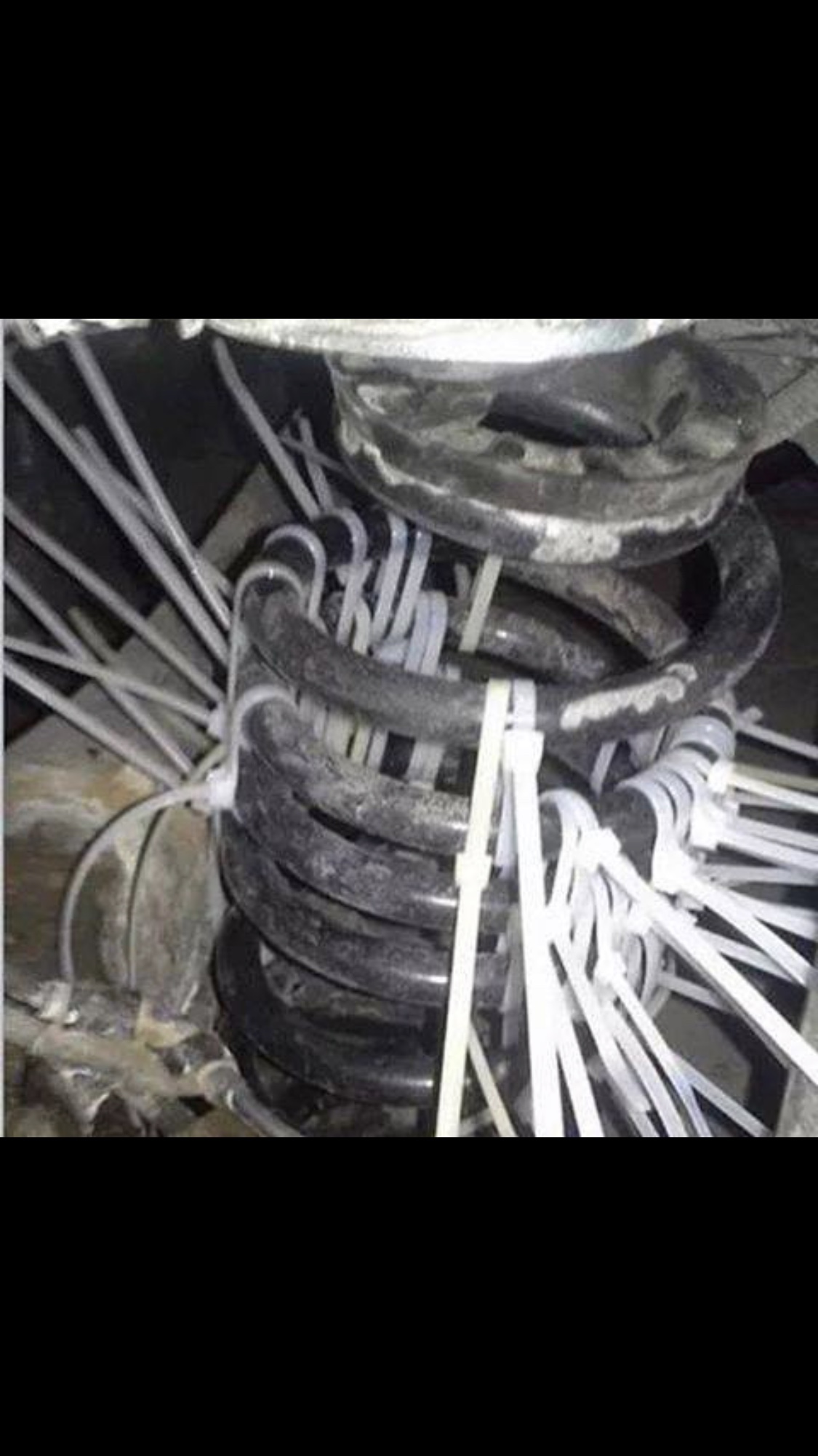

Here’s a hack:
The next time it’s in track mode, do this:
You’re welcome![emoji6]

Here’s a hack:
Kevin, you're a GENIUS! :lol
