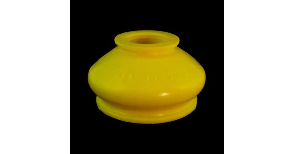

Going to have a hunt on the poly boots site in Bulgaria and find a fit.
Ive sent them an email on closeness of fitment range that a boot can stretch.
I noticed the outer link ends have to stretch about 4mm (1/6th") to fit both seated boot locations. The length for the boots was pretty much spot
HOOKED ON GT
Oct 26, 2006
468
Orlando & Australia
This looks like a great fit for the inner joint.
StuScreen Shot 2021-02-08 at 9.25.35 am.pngScreen Shot 2021-02-08 at 9.25.51 am.png
