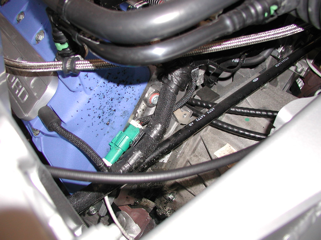

I noticed a couple black specs on the inside of my rear window today and a bad smell after driving the car. When I opened the clamshell, I saw lots of splattered grease on the driver side of the engine and a bolt that has worked its way out of where the rear axle goes into the transmission.

How about the grease? Are you sure this is coming from the halfshaft area? The halfshaft junction should not be a source of grease, since none is normally there. :confused
The grease is coming out of the CV joint; no bolt pressure = leaking

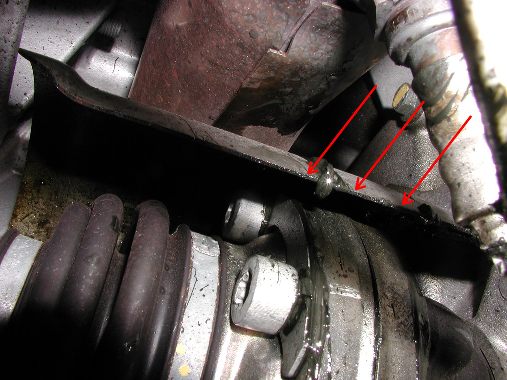

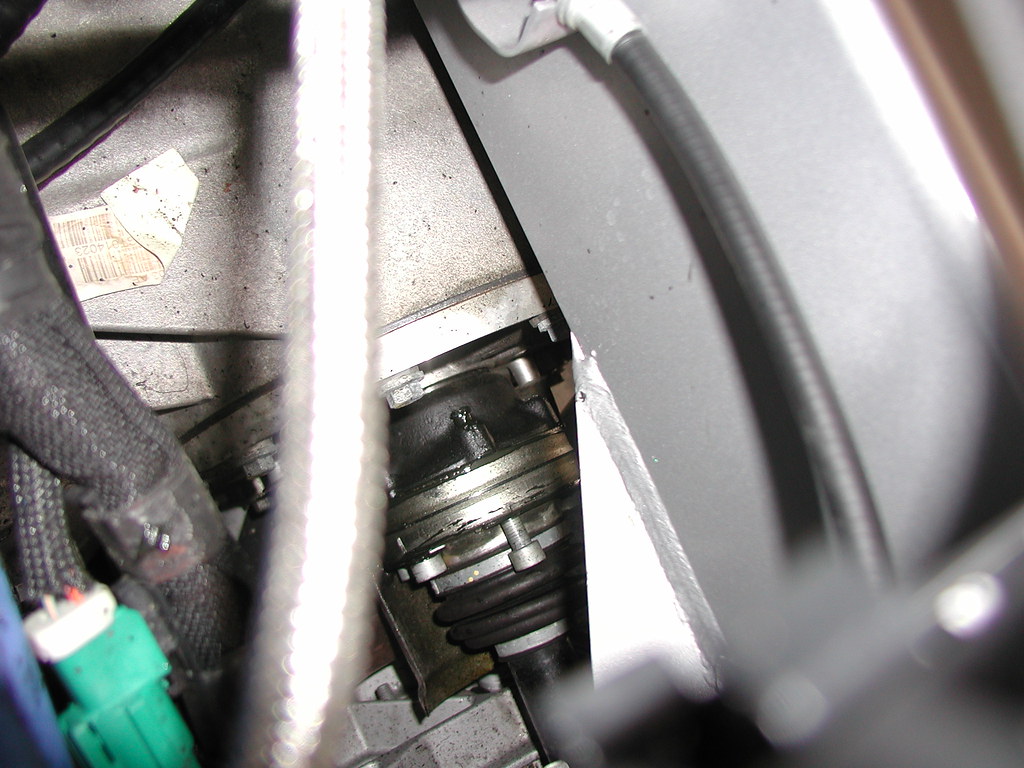

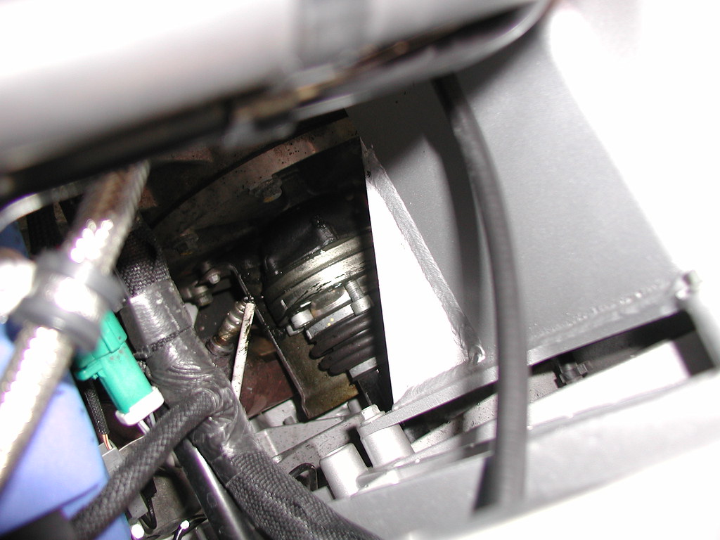

The grease is coming from 3 seams in the flange. This picture doesn't show it well, but inside the half-cylinder shield, there are three parallel lines of grease.
Thanks again for all your comments. I really appreciate them.
4,192
Hi Mark, good pictures. The grease is still a bit of a mystery. In your photo, the CV joint separates from the black transaxle coupler at your right-most arrow. In other words, when we do the axle bolt upgrade and remove those 6 outer bolts, the halfshaft seperates at that right-most seam. The metal band between the middle and right-most arrow is part of a stamped "cap" that fits over the end of the CV joint at the end of the halfshaft. Somehow this cap has become damaged or loose and it is letting grease seep out the seams. Granted, the outer bolts typically help to keep this cap in place and secured, but it is normally pressed on over the end of the CV and tighter than snot even without the bolts.
Best of luck with the repair. Make sure they tend to the repair/fitment of this cap because something is not right - undoubtedly due to damage caused by the loosening of the outer bolts. I would also insist on loosening and re-torqueing the inner bolts to spec - regardless of how they may appear.

In the above picture the drive area of the bolt looks chewed-up, if it is maybe the entire refit was botched. It may be time for an independent going over.

I am sure that in the end you will be fine however for the amount of grease to come out the CV joint had to be either installed crooked or the entire assembly is in fact very loose.
Please have the entire assembly on both sides disassembled, inspected, and the properly reassembled.
My thoughts exactly when I saw that.

On closer inspection, the bolt heads that appeared damaged in the pictures were not damaged. The mechanic invited me back to the garage several times during the project to show me how it was going and let me inspect anything I wanted to. The actual half-shaft bolts had not moved, but he replaced them anyway.
