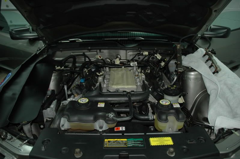

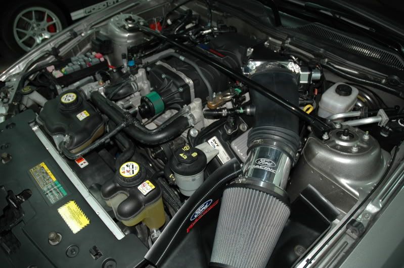

My 2008 GT500 is rather crude but I really love it. I just finished installing a new supercharger, upper and lower pulleys, throttle body, MAF housing, injectors, upgraded fuel pump, headers and widened stock wheels with 305/35R18 Nitto NT555RII extreme track tires. I will have the final dyno tune installed this week. Should be pushing close to 700 rwhp.

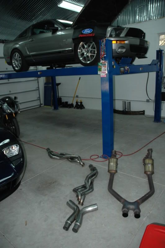

If I never have to put another set of long tube headers on again, it will be too soon. I don't remember it being that difficult when I was younger.
I'm really glad I installed the lighter Innovators West crank damper to prevent my crank from splintering into a million pieces (just kidding Indy-you knew I wasn't REALLY going to let you have the last word).

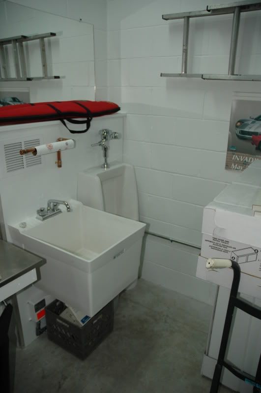

This was my best addition to the garage:
[/IMG]
Now when my wife kicks me out of the house I don't have to make up with her unless I need to sit down and read the newspaper.

Is that a combo sink/toilet? My wife almost got me one for the garage after the last time she kicked me out of the bedroom to the sofa. I really don't mind it too much, it sorta like camping.

9 Dollar tip on the headers:) Drop the k member down and out in 35 mins, support the balencer with a exhaust jack/jack etc and headers go on in an hour:) OThER wise THEY SUCK..............
I was definitely going to ask if you installed a different balancer :lol
Nice work. Should haul some big time ass.
You are right and I thought about it. But then I asked "how hard can it be" and did it the hard way. I went to court a couple days after the install and a judge I know actually asked me what happened to my hands. They looked like I had wrestled pirahnas out of an alligator's mouth. Before this experience I thought mechanic's gloves were for sissys. Now I have 2 pair.
At least the ARH headers didn't require lifting the engine to get them in the driver's side. The flanges are slotted which made it slightly easier too.
Supporting the weight of the engine/tranny with the crank snout?

VMP Tuning dialed my car in on a dyno. 713 rwhp and 704 ft-lbs torque. No doubt the cool weather we are having helped, but I'll take it. If anyone needs a very good GT500 tuner, I can't recommend Justin @ VMP enough. Justin is very conservative with his tunes and takes his time. As a bonus, my indicated fuel economy increased.

ARH headers are good but the Dynatech headers provide a little bit more HP.
Stock mufflers?
What were your boost #'s? 17?
I heard the same thing about the Dynatechs. I went with the ARHs because I am more familiar with them (excellent quality) and I believed (rightly or wrongly) they would be easier to install. The ARHs didn't require removal of the driver's side motor mount or lifting the engine to any degree. The ARHs slid right in after removing the starter and unbolting the steering shaft from the lower joint. However, there were several flange bolts that were extremely difficult to get to and were the cause of my bloodied hands.
I am still running the stock mufflers. They sound very good with the headers and high flow cats but I get way too much popping on deceleration. Some don't mind it but I don't care for it. I'm installing Borla Touring mufflers shortly and hopefully it will go away. I understand it is a common issue with the long tube headers on the GT500.
I was pushing a little over 19 on the boost. I didn't expect it to be that high. A ported blower and plenum should yield another 30-40rwhp but I prefer not to have any more power with the stock rods. Too bad it doesn't have the GT rods. I'm already well over 800bhp and I don't want to push my luck.

I have the Borla Touring mufflers. Sound great. Low key until you stomp on it. They pop at first when cold, however, once they warm up, they sound great.
Wow. 19+lbs. That is hard to believe. I sometimes hit 15lbs. I basically almost have the same set up less the IW 10% under pully. hhmmmm??? I thought the IW has suppose to give you 2-3 lbs max. Also, your setup is almost identical to Justin's TVS setup and he hit 748RWHP, but I think he changed out the FI to 80's and different TB and 1-peice driveshaft. I guess when you add up those = 30+RWHP.

I also have a slightly smaller upper pulley than yours (2.59 v. 2.65) with the 10% OD lower. I'm also running catalytic converters, albeit small ones. These, in combination, probably account for the higher boost pressure.
I'll post the dyno chart when I get home.
Justin has the GT cams, ported blower and plenum, larger injectors and TB. I think he is close to 775rwhp at this point. The GT cams have a longer duration and while he is getting more power up top, he lost an equal amount down low.
I spoke to Paul at Paul's High Performance and he recommended the fuel set up I have. I have dual 310l/hr pumps with the 60lb FRPP injectors . The driveability is excellent at all rpms. Paul builds the upgraded fuel pumps for the Ford Racing Whipple kits and, if I'm not mistaken, also does the pumps for the Cobra Jets.
