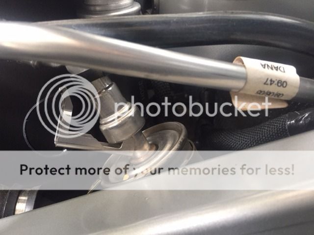

ADDED:
Here are two photos I did take when removing the top safety clip. In this one, I've moved the top of the clip off the hardline and that's when the lower part of the clip will not clear the flange. You can also see how the end of the hard line expands in size a bit. I then replaced the top of the clip on the hardline, pushed it down and off it came.
Here is the safety clip removed. It shows the fangs on the bottom of the clip and the top part of the clip that must be pushed down over the hard line.
