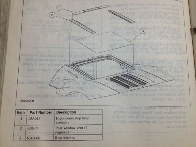

Are these the parts you are referring to, Item 2 on this diagram? This is my 2005 manual.

try 5G7Z-17232-AAD (RH AND LH)
and/or 5G7Z-6B670-AA (RH), 5G7Z-6B670-BA (LH) this is probably what you are looking for

Hi KJRGT yes those are the pieces, fantastic thanks so much. by the way they don't look painted I agree, I would have sworn they were just plain moulded matt plastic, until the sticky tape took the surface of them and the thin layer of paint or some sort of laminated surface treatment was on the tape and stripped gaps left on the vents !
