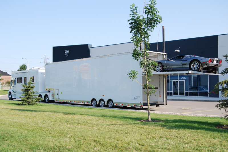

This one works and you have extra room for your buddy's cars - or whatever.:biggrin
7,081
Darn, I want a bigger trailer...... That Pace you have is fantastic, toter is nice too.....
