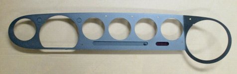

The OE tach face is a non-circular shape, but the hole in the panel behind it is smaller and circular if I recall correctly. So putting a round gauge in the OE panel should work.
OE dash panel;

Not to be negative, but why bother? I'm not sure about current prices, but when I bought mine, the Speedhut gauge panel and all the gauges cost less than the Ford speedo or tach cost. In addition, the Speedhut panel is slightly smaller than the stock one so is much easier to change.
Agree, I like the Speedhut gauges.....the custom colors, the shift lights, and the reliability. Glad we have that option.
