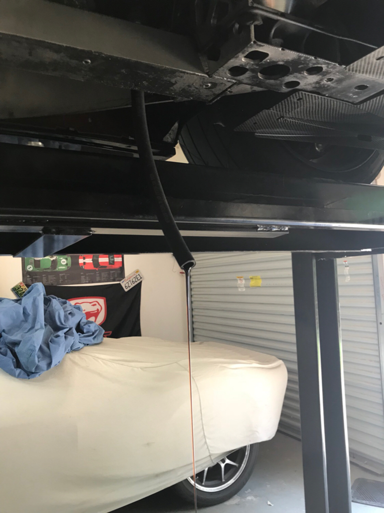

7,090
I have one of these that I use to keep the tank drain off the frame. Handy for many other cars too.
Whoa, that's cool!
