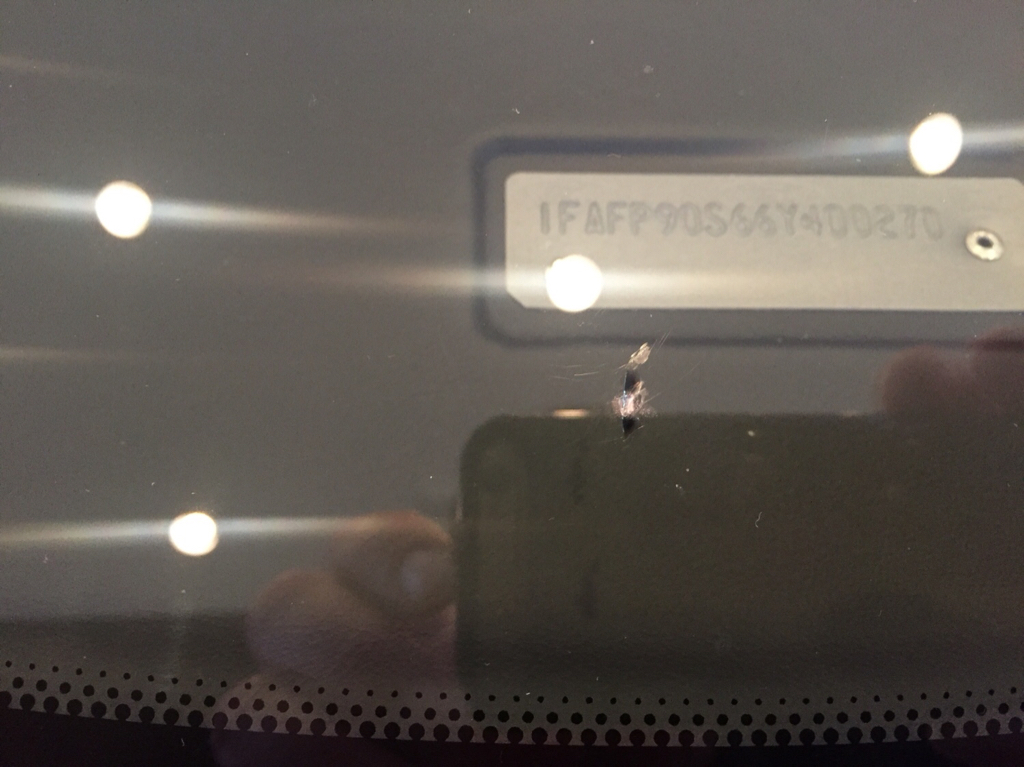

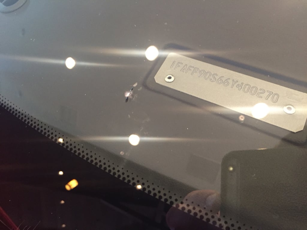

I bought the ClearPlex from Trent/4N a few years ago, but only got around to having somebody install it for me a couple of weeks ago. I took the car out for a quick spin yesterday morning, and a big truck threw a rock at me, down low on the drivers side of the windshield. Looks to me like it pierced the ClearPlex and injured the glass. There is a dark line visible under the film, about 1/3” long. As bummed as I am about the irony of this damage, immediately after having the ClearPlex, I’m sure the damage would have been far worse if I didn’t have it installed.
My question to the forum regards potential windshield repair. I believe I recall that you can do a chip repair right through the ClearPlex; is that correct? I showed a buddy of mine, and he warned me that it might be risky to try to fill it, since the technician usually will drill into the windshield, and perhaps I should leave well enough alone. Thoughts ?

Clearplex is plasctic so if the rock has sharp edges , is large or thrown with force it is going to get cut thru,, I had one go through my film on my 06 but It never cracked. It looks like yours has a small hair line crack. With out the film it would have be much worse.
I have never seen a repair where they drilled the glass. I have seen them use a vacuum pump on one side of the glass and they drawn /suck a clear epoxy type resin from the other side of the glass into the crack. I would find someone who performs this method and see if there is enough space on the inside for this process, .
Clint, that looks like a straighforward repair. However, I think the film needs to come off to do it correctly.

Clint, unless the film has a hole in it, it will have to come off to do the repair. If you have ever tried to repair a windshield crack yourslef (not that I would on this car), the results can be decent. But you have to excavate the defect of any remaining glass debris and then inject it with the epoxy followed by placing it under vacuum. Don't see how that can be accomplished with the film intact.

Thanks for the input, guys - much appreciated. I think I will first try excising a small circular hole through the ClearPlex for access for the repair (maybe 3 or 4 mm- will get input first from the repair person) using a punch biopsy instrument (tool of my trade), and then see how it looks after the repair. If it looks like crap, I can always then remove the entire film and start over. It’s just unfortunate that this happened so soon after installing the film. Would like to have gotten a bit more use out of it before replacing it, but I guess at least it’s not a high-dollar item. I wonder if more of these are available from Trent? I don’t have any “certified” installers in my area, but my tint guy wasn’t too intimidated when he learned it was precut, and did a fair job. I was actually pretty impressed with the clarity- only problem we had was a few air bubbles at the edge that were hard to get out.
To address your title of the thread, nope, I think the film did all it could. This was dull blunt trauma.

I will add that you want to get the crack fixed ASAP, as cracks will grow if you don't fix 'em quickly.

Good point guys. I don’t plan on moving the car from it’s current position in a climate-controlled space until this is addressed (soon). Thanks.
