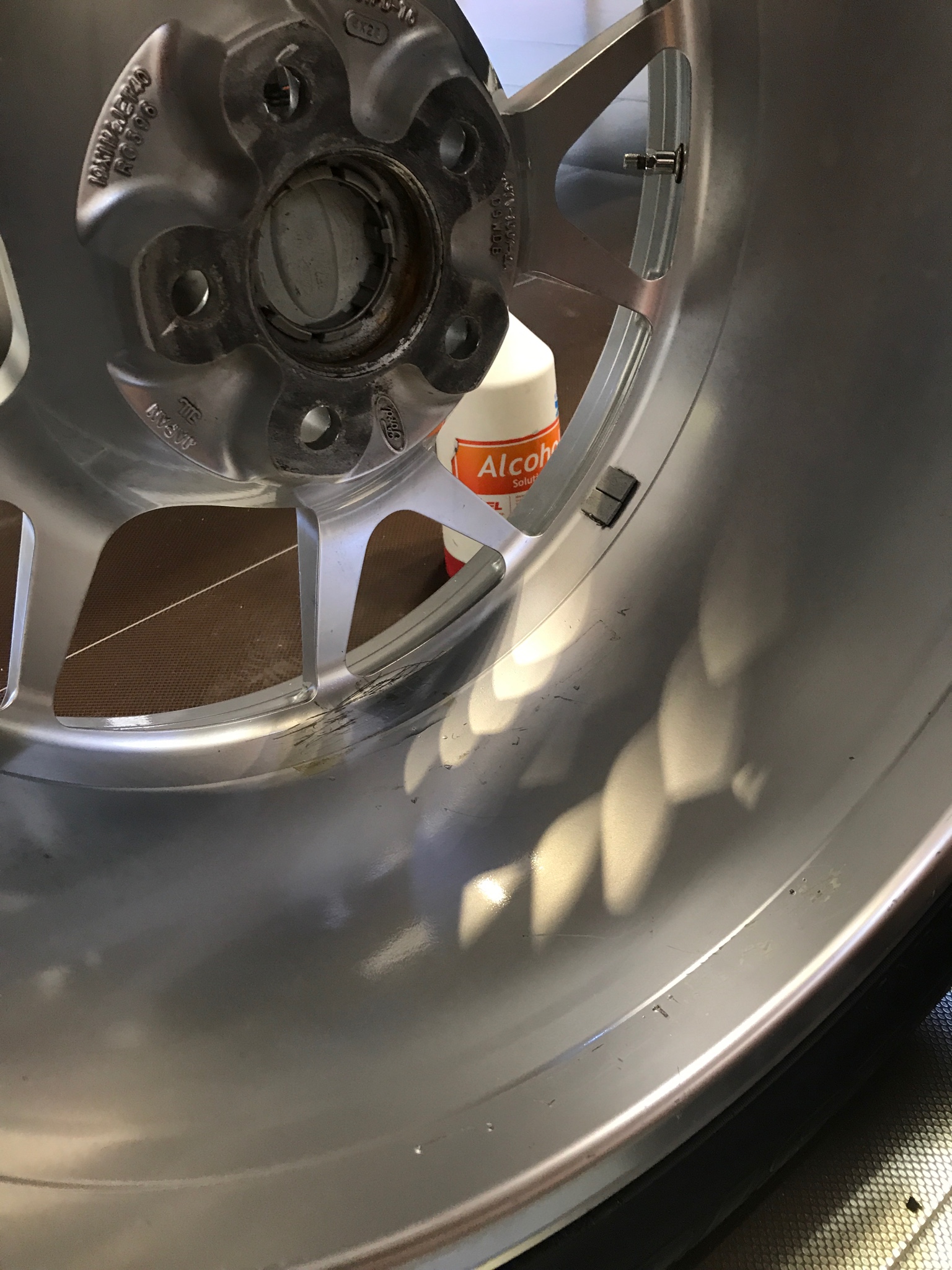

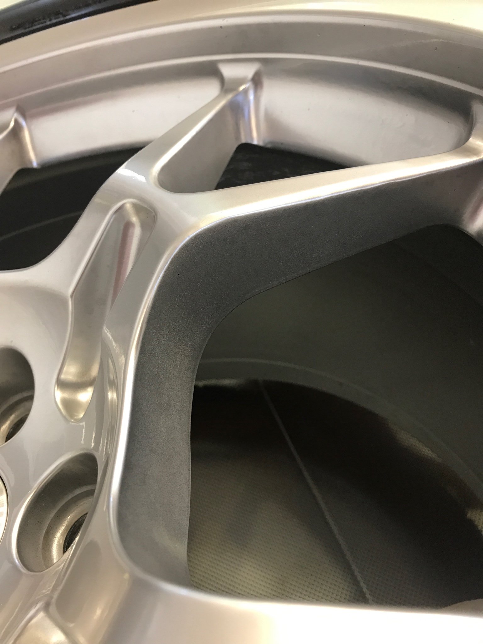

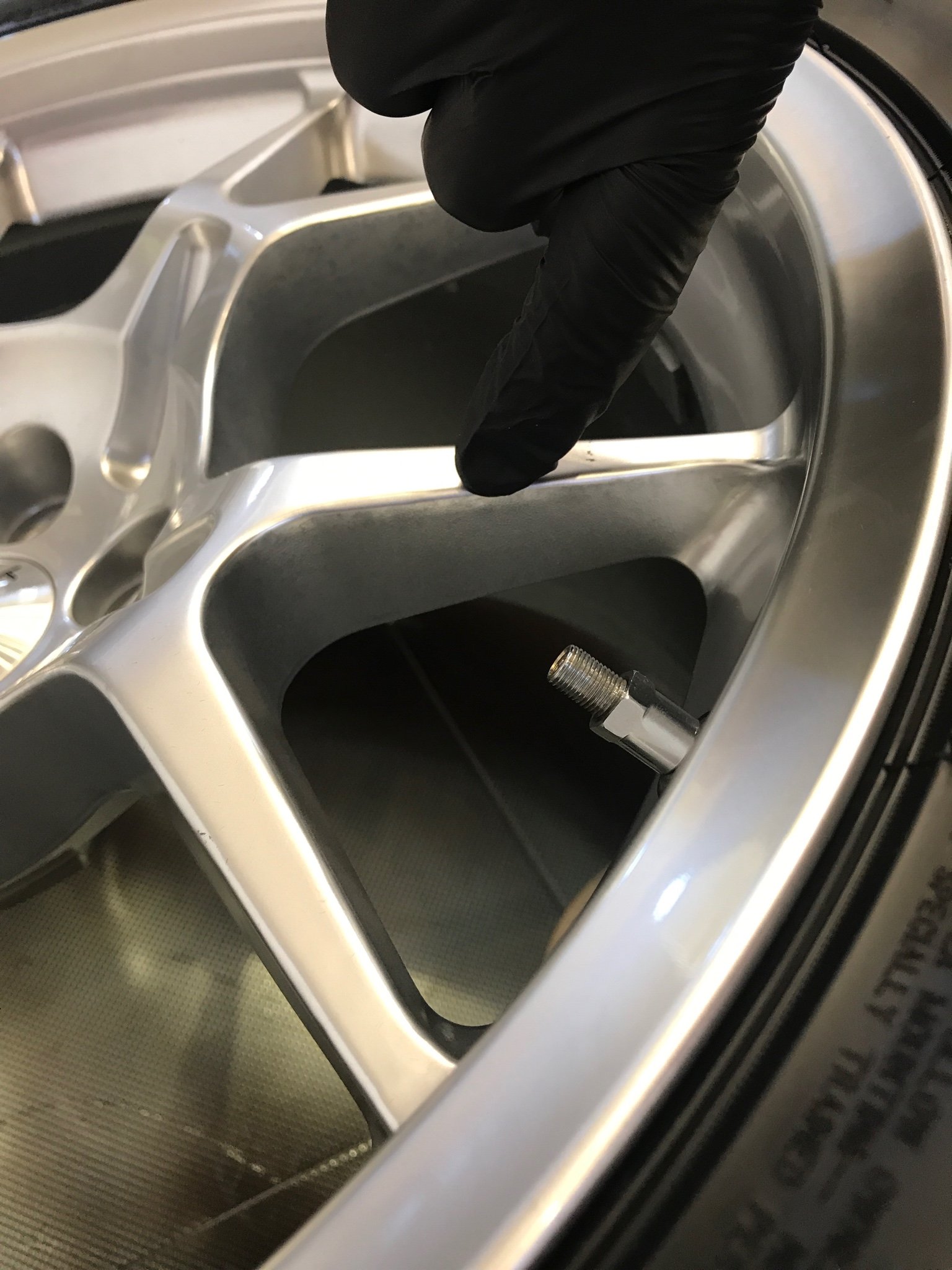

I'm doing the clear film on my car recently the installer noticed the finish on the wheels
Is for lack of a better term...stained. He's suggesting doing some process that sounds like powder coating but I may be off. What have you guys encountered with your GT's wheels? Here are some pics for your review. As always I'm extremely grateful for all the feedback this wonderful forum provides.
This last pic shows some scrape marks from a tire change years ago. Some dumby went at the balancing weights with a screwdriver.

He doesn't do the work that he's suggesting. He could be brokering services but the wheels are still not quite as I'd like them to be. I'm curious why they look like that since they've been in a temperature controlled environment since 2005.

I had some slight discoloration on mine at one point. Seemed to be melted on tire or brake residue.
I used a rag saturated in WD-40 and it removed nicely.

if you are going to refinish them my suggestion would be to paint them rather than powder coating them.Powder coating wheels should be done in a low temp process so that the metalurgic makeup of the wheel is not changed which in turn can weaken the wheels.Usually most places that do power coating bake the parts in high temp ovens and for wheels on a high performance car this isn't a good thing obviously.
Agreed. The problem is we can't get a paint designation from BBS. Seems like we need to choose a different paint scheme and give it a try.
I for one am contemplating BMWs wheel paint. It has that silver and brilliant look in the sun as do our BBS wheels.

Problem is the paint coverage is thin in areas. At least on my wheels. Compound of any kind won't help. Not enough paint coverage to make it work.
7,850
Powder coating is good if you want a solid color like plain black but metallic colors like the OEM BBS wheels are painted.
just have all of the wheel refinished repainted so that they can match trying to match one to the rest is a long shot. the cost is minimal also, should not be more than 150 to 200 per wheel.

If you powdercoat, be careful about checking nut torque. The coating prefeably should not be done in the wheel nut seat area. A mate of mine had his car's wheels powdercoated and one fell off at the track because the coating broke up under the nut seats.

I had a strip weight pull off paint. Went to local mobile wheel restoration guy who was located at Mercedes dealer. Mercedes dealer was located next to several higher end car dealers. He did all the wheel repairs for dealers in that area along with Discount tire. He custom blended paint to match BBS wheel and came out great.

I would be more vigilant about cleaning the dust / dirt / grime off wheels; also, dont use ANY wheel cleaners (mothers, griots, simply green, etc).
Hot water and soap and soft rag is all.
I used several mobile wheel guys from dealers to franchised on my Vette and long term none held up over 40K mi. and varied in finish/gloss/etc.
My take, is no paint will be has hard as OEM and will chip from rocks over time.
Might make it worse; and as we seen in auctions/sales OEM, bone, stock, factory, original seems to be >$+ preference.
