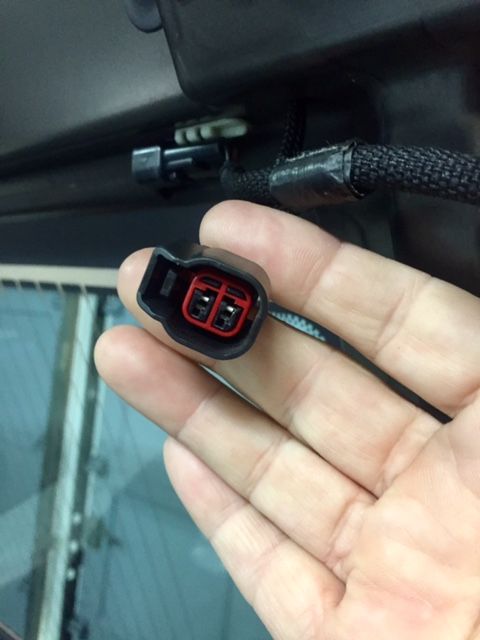

I need to replace my high placed stop light and the new one comes with wiring but not a new female electrical connector.
Is there a way to reuse this one or do I need to try to replace it?
Thanks!

The new brake wires have no connector or terminals. Only wire endings. I picked it up today.
I'll have to better scrutinize the connector to see if there are release points of some type.

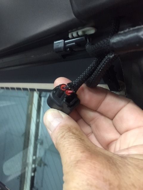

I'm still trying to figure out how do I extract the original wires and terminals from the connector housing itself without damaging it. As the second photo shows, the wires first enter the connector into a red plastic part before the terminal.
A Ford tech most likely has access to another female connector. I did my best to find this connector in the 2005 GT Wiring Diagrams manual and while one wiring illustration shows it as C475, the illustration in the connector section looks nothing the same. It only shows the male connector, can't find the female.
The terminal very well may be a 14487A. If I get it out I can verify just which terminal to replace with.

Ok.. since I ran my big mouth about it, figured I owed it to you to help extract the wires. This is the connector for the clam switch, but they are exactly the same. Was just easier for me to access.
First you pull out the rubber seal (rectagular orange thing, 1st pic)
Then pop out the retaining clip (other orange thing, 1st pic)
Then press back the clips on the connector (arrow is pointing at it, 2nd pic) to release the wires
You may be able to re-use the wire seals (ribbed green rubber things, 3rd pic) when you source terminals
Good luck! :thumbsup
