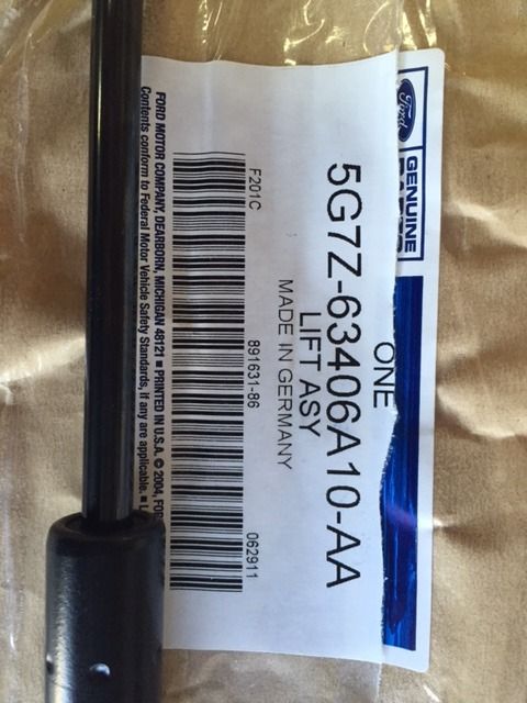

5G7Z-63406A10-AA Part number for rear strut. Says Made in Germany on part number. Replace in pairs for best performance
Seeing this thread last week got me off my rear and I ordered the struts from my local Ford dealer.
Picked them up today and snapped (literally) them into place. No more droopy clamshell.
Here's the label.
